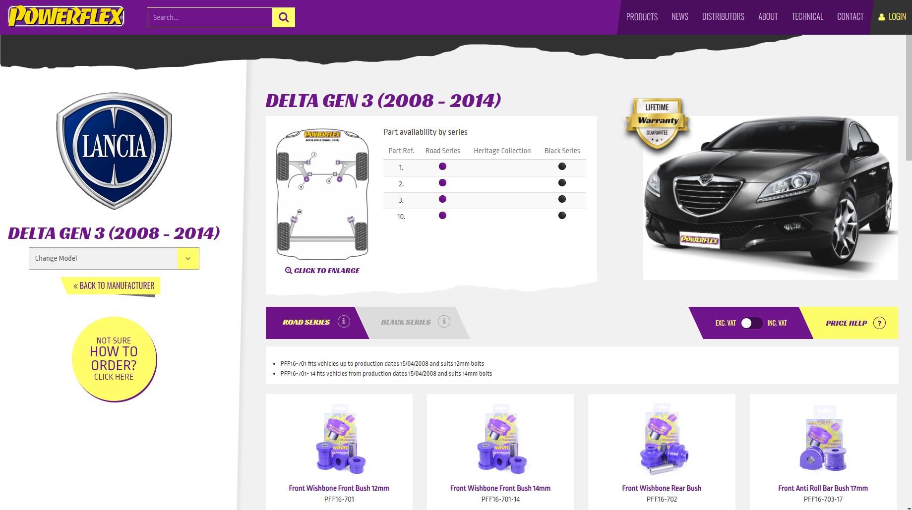

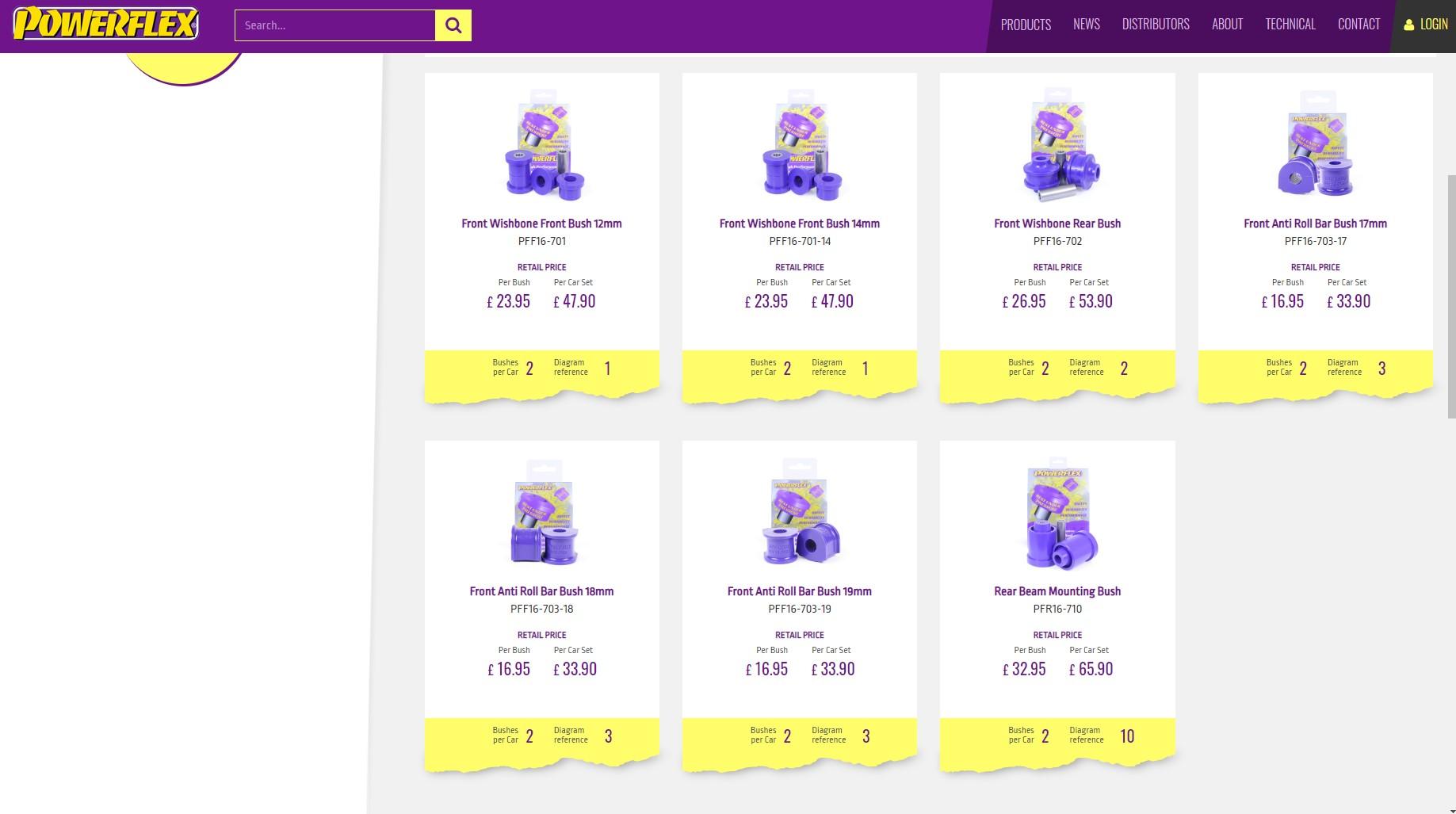

darkman14 7061 Posted September 17, 2020 (edited) @VeljkoG Gumice balans stangle: https://www.powerflex.co.uk/products/Delta+Gen+3+(2008+-+2014)-3383/1.html I u Indjiji neko pravi po narudzbini, ne znam ko. Ali nisu neki kvalitet, koliko mi se cini Edited September 17, 2020 by neshaoct dodao printscreen & tag 1 neshaoct reacted to this Quote Share this post Link to post Share on other sites

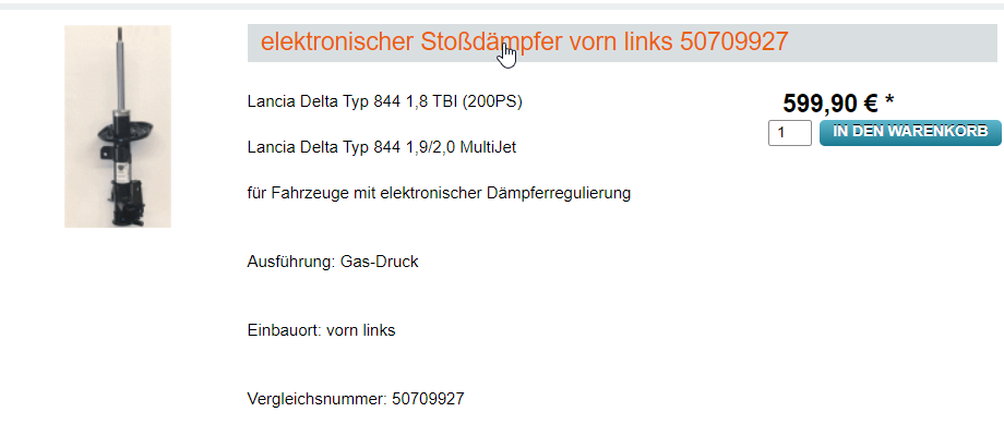

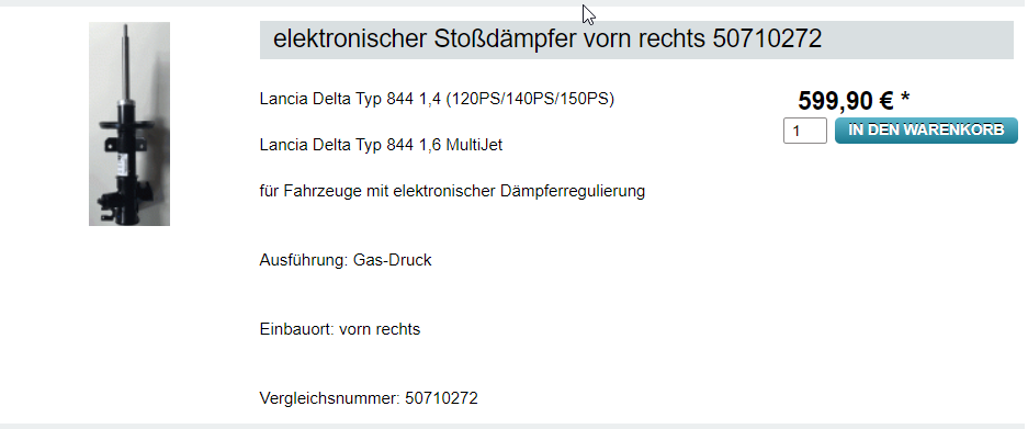

darkman14 7061 Posted September 17, 2020 Evo i jeftinije, samo treba dovuci https://italo-fahrzeugteile.de/Ersatzteile-LANCIA/Stossdaempfer-Federn-Domlager/Stossdaempfer/Delta-Typ-844/ Quote Share this post Link to post Share on other sites
PremieRacing 6462 Posted September 18, 2020 (edited) Šta je jeftinije, 600eur/kom. ? Može zamena za obične amorte, ne električne, ali ti treba ovo: https://www.kwsuspensions.net/kw-cancellation-kit-for-electronic-damping-68510118.html Možda neko i to može da napravi za manje para od KW (gotovo pa sigurno). A može i reparacija: https://nagengast.pl/en/regeneration-of-shock-absorbers/ Jedino Ne znam kod koga da te uputim u BG da ti bilo šta od preporučenog uradi kvalitetno... Još mi nije trebalo Edited September 18, 2020 by PremieRacing Quote Share this post Link to post Share on other sites

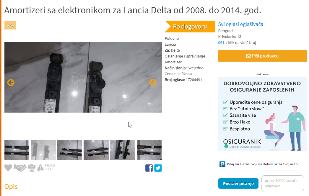

darkman14 7061 Posted November 5, 2020 Ako ko trazi https://www.polovniautomobili.com/auto-delovi/17204491/amortizeri-sa-elektronikom-za-lancia-delta-od-2008-do-2014-god Quote Share this post Link to post Share on other sites
dekirs 5152 Posted November 5, 2020 Koju li je cenu odvalio bas me zanima Quote Share this post Link to post Share on other sites

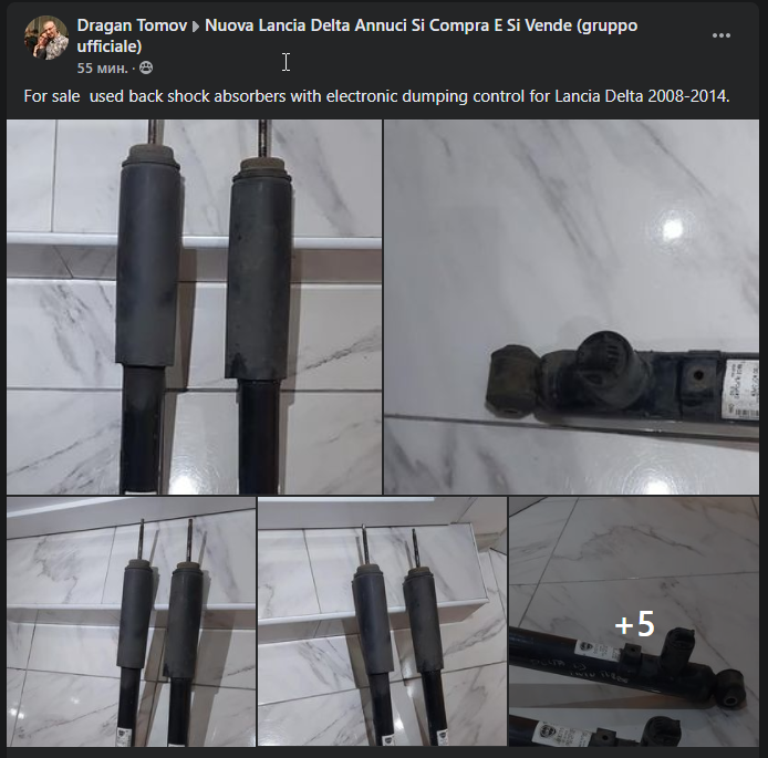

darkman14 7061 Posted December 1, 2020 Iskocili jos jedni na FB, nema cene 1 Ivan reacted to this Quote Share this post Link to post Share on other sites
