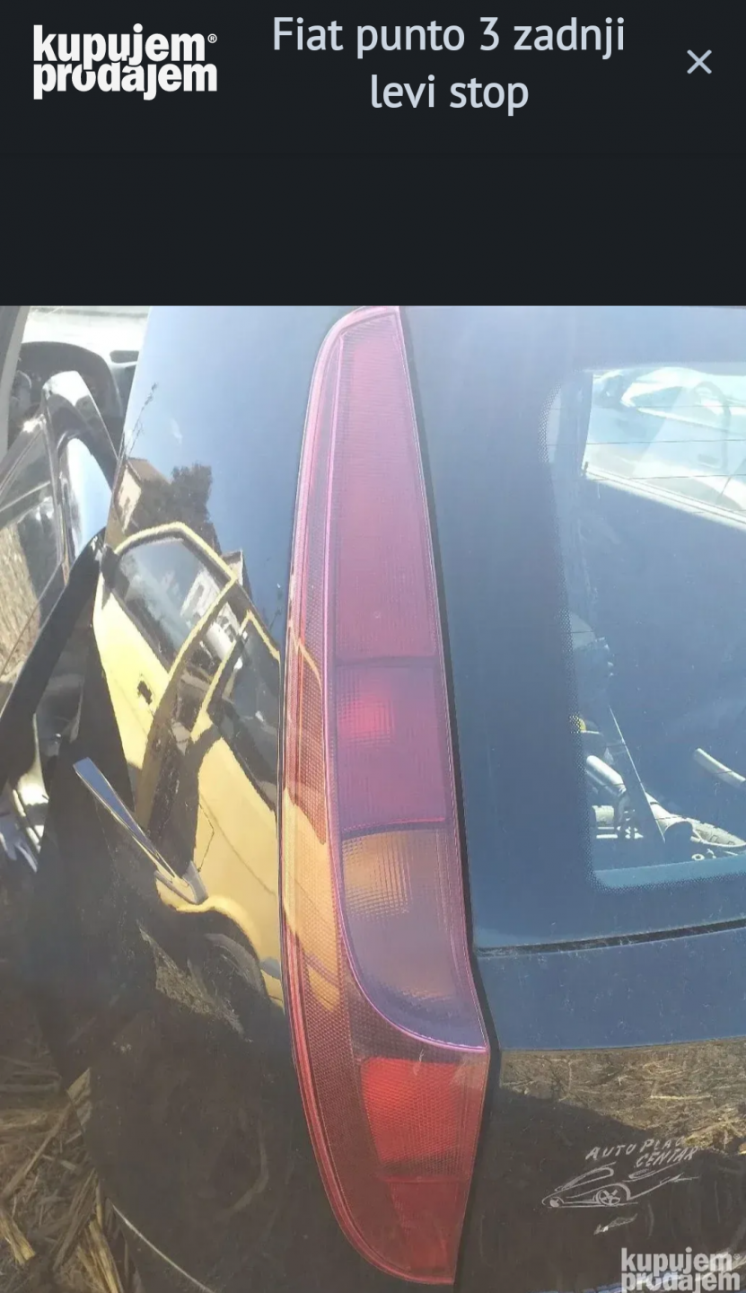

neshtry 18261 Posted September 24, 2024 Kako ćeš ovaj oblik da bušiš? Nema šanse... Evo za 20€ i uživaj https://www.kupujemprodajem.com/automobili-delovi-i-alati/auto-elektrika/fiat-punto-3-zadnji-levi-stop/oglas/162785250?utm_source=kp&utm_medium=interfejs&utm_campaign=social_share&utm_content=oglas 2 darkman14 and nemanja84bg reacted to this Quote Share this post Link to post Share on other sites
