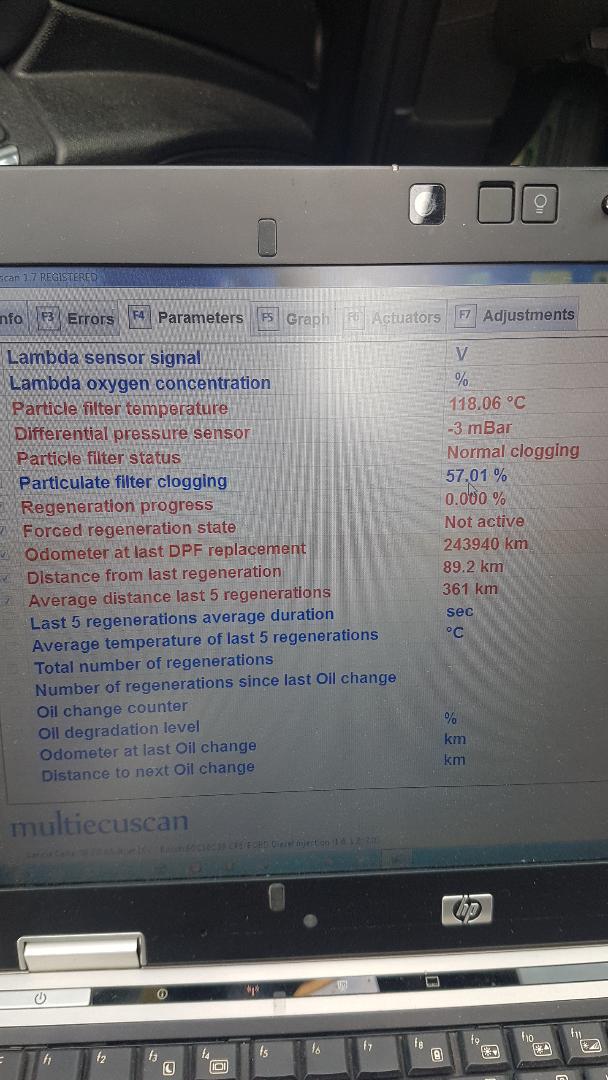

tata78 1 Posted January 9, 2018 (edited) Bio na diagnostici, 57% filter zaprljan. E sad jel to mnogo ili je normalno ne znam. Edited January 9, 2018 by tata78 Quote Share this post Link to post Share on other sites
skile86 617 Posted January 9, 2018 To je normalno, trazi dalje. Quote Share this post Link to post Share on other sites
srdjan1989 1 Posted January 9, 2018 3 hours ago, tata78 said: Bio na diagnostici, 57% filter zaprljan. E sad jel to mnogo ili je normalno ne znam. Jel i dalje imas problema sa lupanjem i variranjem obrtaja? Quote Share this post Link to post Share on other sites
tata78 1 Posted January 9, 2018 (edited) Imam kada radi regeneraciju. Edited January 9, 2018 by tata78 Quote Share this post Link to post Share on other sites
