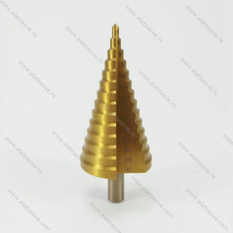

Milutinac 6346 Posted October 28, 2016 @Dezurni - cime vi kospodine dezurni predlazete da si busi klapna, moze li obicna busaljica, ili mora hilti, ili cak eventualno neki pneumatski cekic? Quote Share this post Link to post Share on other sites
Dezurni 399 Posted October 28, 2016 Može da se bira rupa po želji Quote Share this post Link to post Share on other sites
