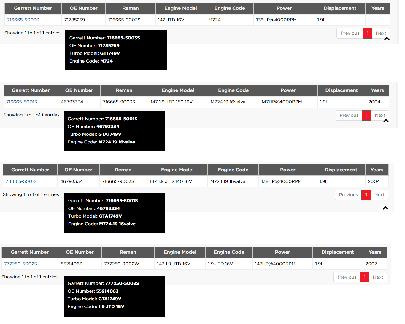

Cvele2323 0 Posted April 19, 2020 Da li su iste turbine na 147-ci od 140ks i 147 150ks? Quote Share this post Link to post Share on other sites
Ivan 25197 Posted April 19, 2020 Po Garrett katalogu, za 2004. modele od 140KS i 150KS, sve je identicno. Model turba, Garrett SN, OEM SN: Za ostale je isti model turba, ali se razlikuju Garrett SN i OEM SN. Mozes i sam da se igras sa parametrima u njihovom katalogu, pa pogledaj: https://www.garrettmotion.com/turbo-replacement/aftermarket-reman-turbochargers-catalog/ 1 Woodoo reacted to this Quote Share this post Link to post Share on other sites
