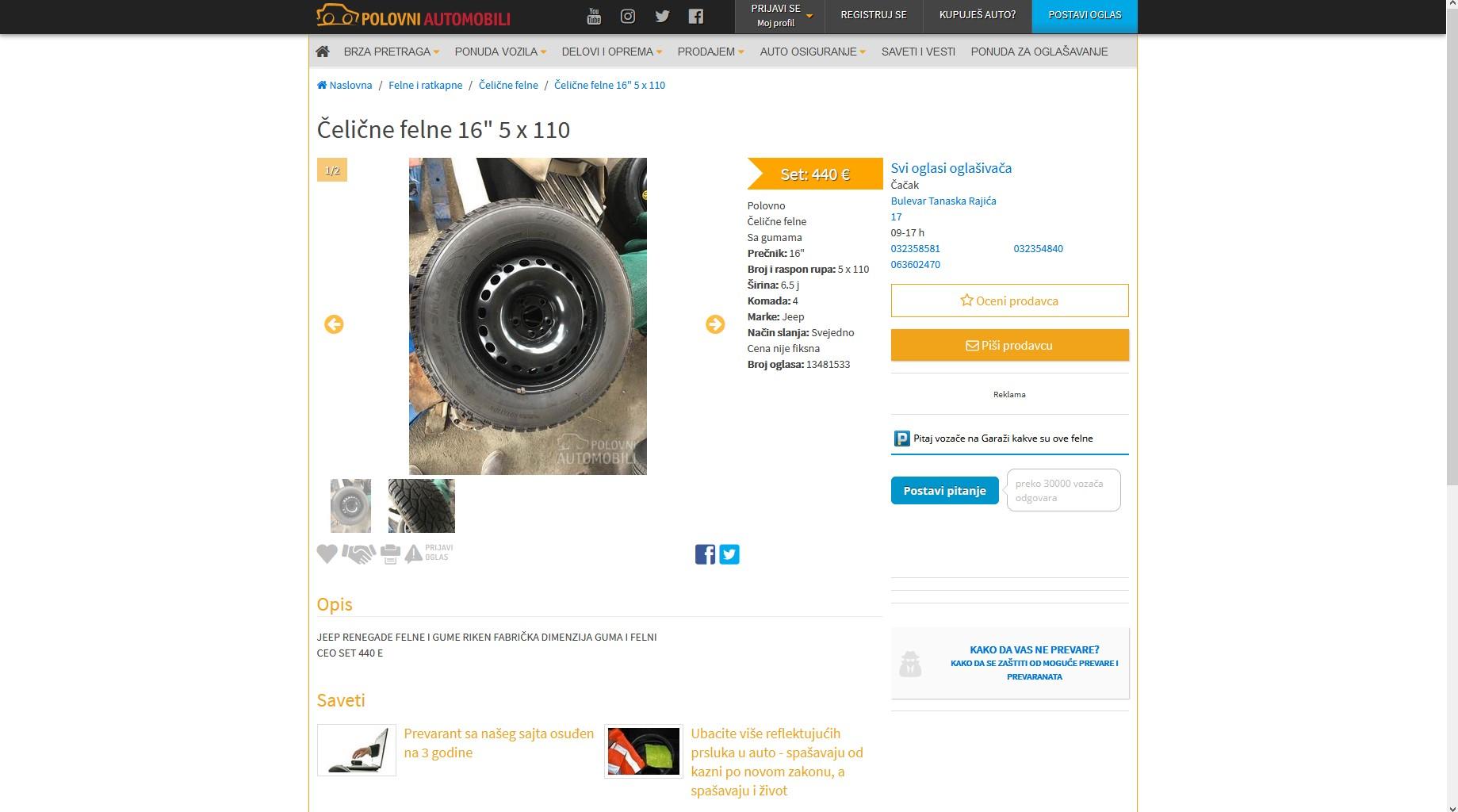

knezevic76 10088 Posted October 19, 2020 (edited) Koliko para su senzori bokte! Naleteo na ovaj oglas , samo kapiram da fale senzori https://www.polovniautomobili.com/felne-ratkapne/13481533/celicne-felne-16-5-x-110 Edited October 19, 2020 by neshaoct dodao printscreen Quote Share this post Link to post Share on other sites

knezevic76 10088 Posted October 19, 2020 Ja bih ove sa oglasa bez problema. Bitno je da nisu zarđale, čak i da je neka kriva, što čisto sumnjam, ispravi se za desetak eura. Ostane keša za druge stvari. 3 djomla, Kosta Smosta and darkman14 reacted to this Quote Share this post Link to post Share on other sites

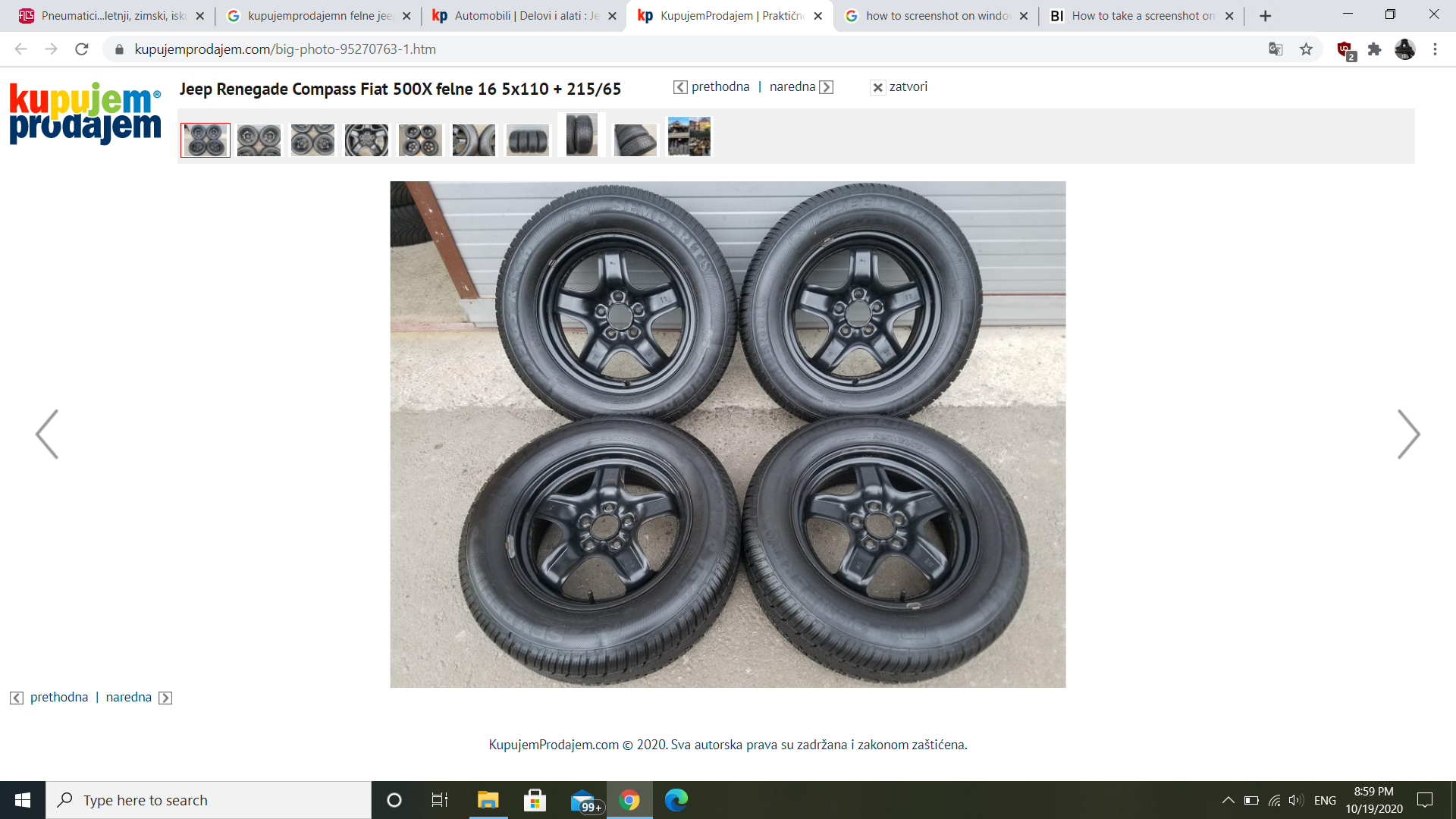

VladaG9 163 Posted October 19, 2020 https://www.kupujemprodajem.com/automobili-delovi-i-alati/auto-felne/jeep-renegade-compass-fiat-500x-felne-16-5x110-215-65/oglas/95270763#photoBig Evo to su ove felne, inace njegove original. Meni je to i najveca dilema kod polovnih. Ne bih da ispravljam i da budzim felnu, jer uvek posle moze da se javi problem vibracija. To mi je posle dodatno cimanje i trosak. Quote Share this post Link to post Share on other sites
dekirs 5152 Posted October 19, 2020 Ispravljenje felne je 1500 din, balans svih tockova na hunteru mozda 3000, nije to rocket science, ispravljaju se i mnogo skuplje i ozbiljnije felne. 3 1 VladaG9, Axic, knezevic76 and 1 other reacted to this Quote Share this post Link to post Share on other sites
