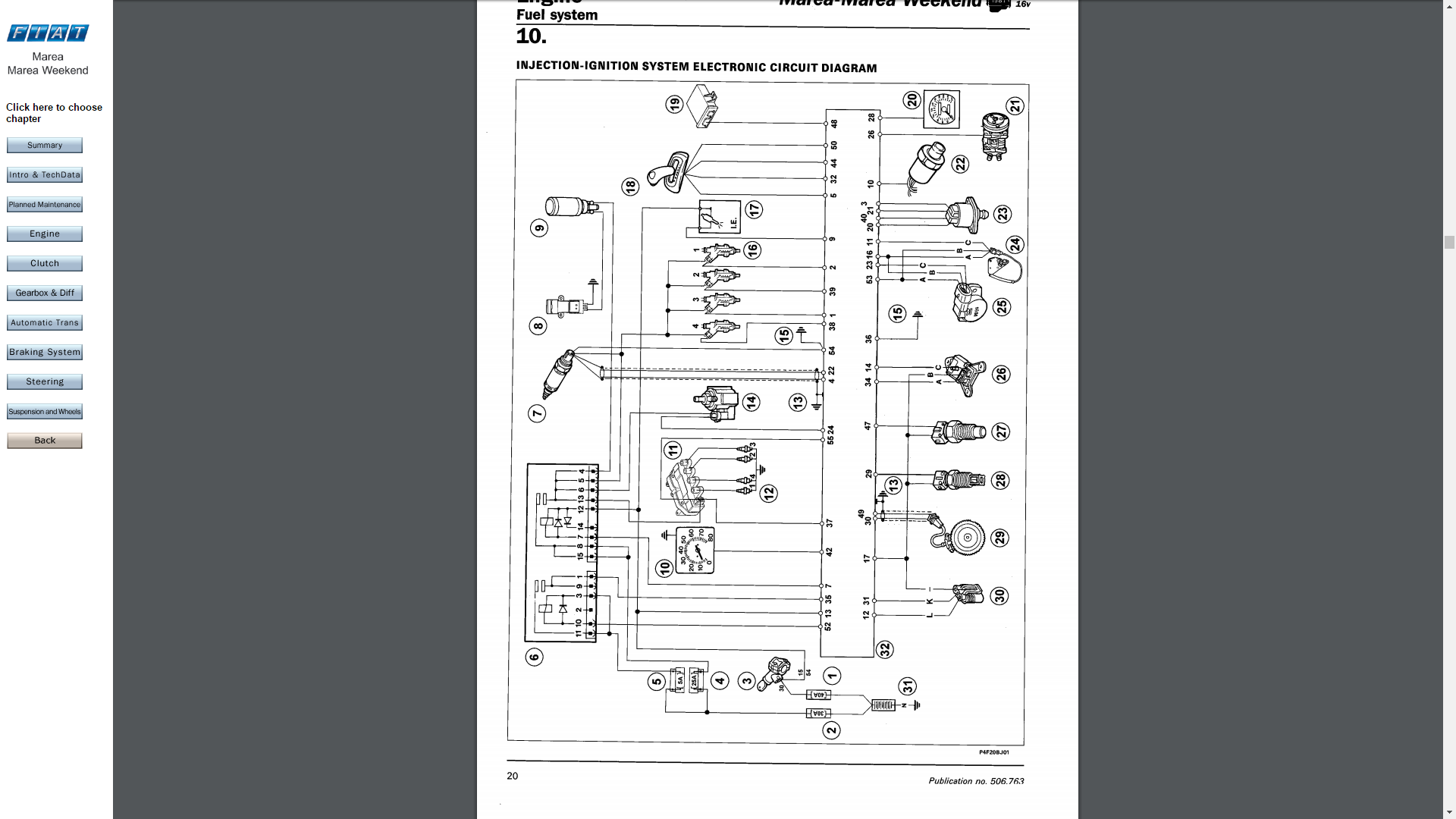

ivan.ik 625 Posted June 26, 2016 Nadam se da će ovo da ti pomogne Quote Share this post Link to post Share on other sites
gakovo 0 Posted June 27, 2016 Hvala Ivan.Ik to mi je jako mnogo pomoglo resio sam slucaj bila je zica u prekidu. Quote Share this post Link to post Share on other sites
ivan.ik 625 Posted June 27, 2016 Nema na čemu. Quote Share this post Link to post Share on other sites
