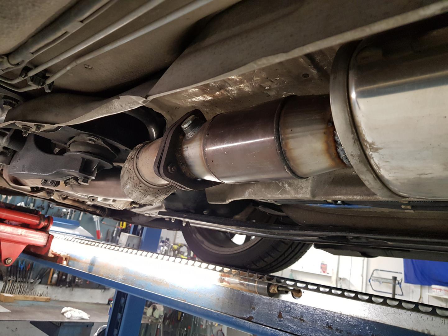

bojke 134 Posted November 24, 2017 Katalizator 100 celija za motore velikih snaga,ne gusi motor a ipak ima funkciju. Meni je potreban samo da bih malo smanjio buku u kabini,jer zbog totalno protocnih lonaca ume da bude bucno u kabini ako se vozi neka duga tura . Quote Share this post Link to post Share on other sites
YUgisa 3228 Posted November 24, 2017 Treba nam dyno da vidimo koliko je to velike snage u pitanju Quote Share this post Link to post Share on other sites
bojke 134 Posted November 24, 2017 48,8 ks ko u malo boljem jugu 45 Quote Share this post Link to post Share on other sites
YUgisa 3228 Posted November 24, 2017 (edited) Au pa to drugom slajfuje, a trecom kopa, cetvrta vec sarme zavija Edited November 24, 2017 by YUgisa Quote Share this post Link to post Share on other sites
bojke 134 Posted November 24, 2017 sve znas 1 YUgisa reacted to this Quote Share this post Link to post Share on other sites
PremieRacing 6314 Posted November 24, 2017 Kat? Quote Share this post Link to post Share on other sites
bojke 134 Posted November 25, 2017 Da, sa metalnim monolitom za maksimalan protok. Inace je njihova trajnost mnogo veca od keramickih koji mogu da puknu zbog visokih temperatura izduvnih gasova i da prave buku unutar samog katalizatora ako se neki njegov deo slomi. Pa cak i da zapuse. Zato se koriste u motosportu maksimalno kao i kod tjuniranih automobila. Quote Share this post Link to post Share on other sites

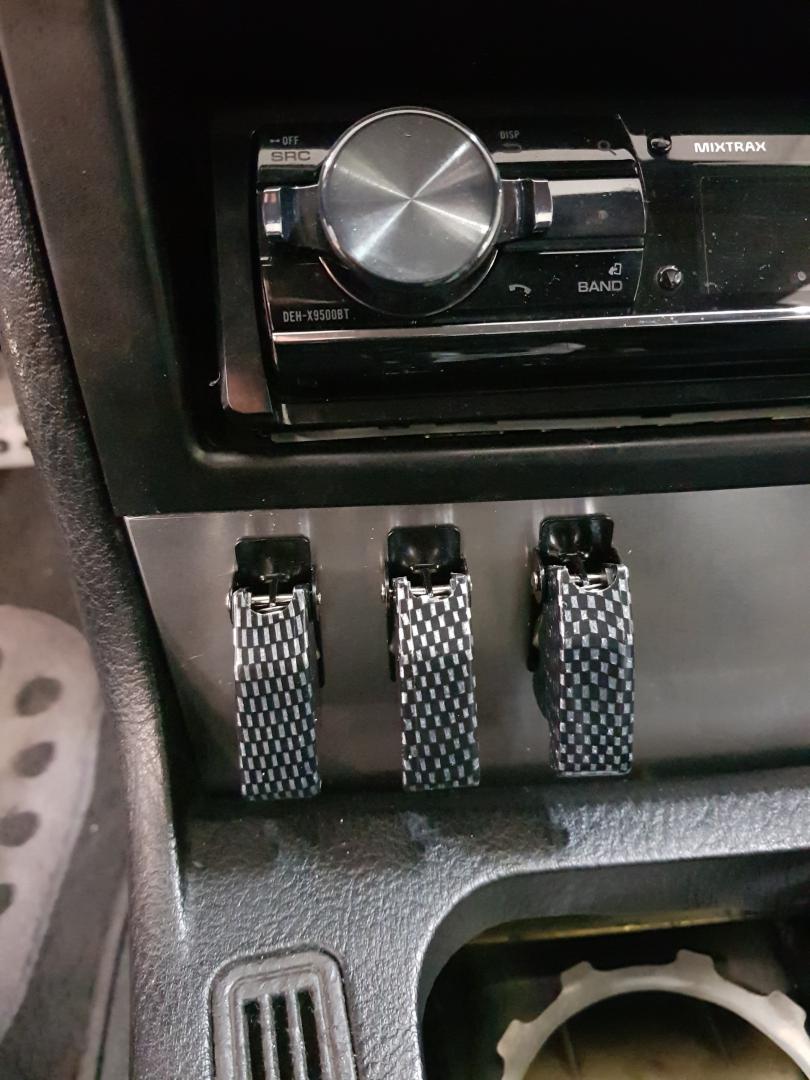

bojke 134 Posted December 5, 2017 (edited) Edited December 5, 2017 by bojke Quote Share this post Link to post Share on other sites

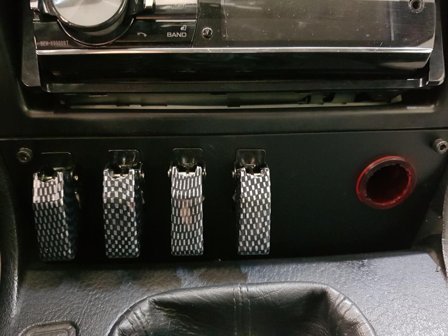

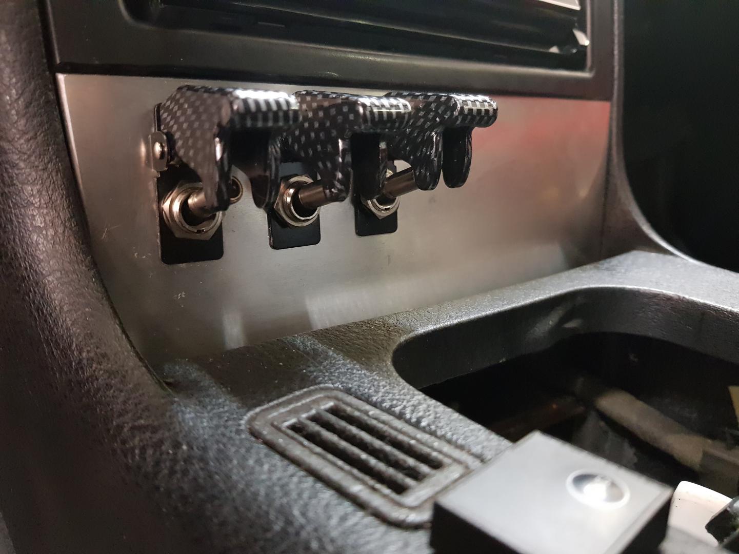

silenci 2817 Posted December 5, 2017 ovo si izvadio iz gripenajel ovo za ispaljivanje raketa il prekidaci za turbo i nitro i sevanje iz auspuha Quote Share this post Link to post Share on other sites
bojke 134 Posted December 5, 2017 Bice tu raznih igrackica. Panel je tek u izradi jos se planiraju funkcije za prekidace.Ali sigurno ce biti prekidac za launch control,hi boost map,kao i za manuelno startovanje ventilatora za hladnjak(za track day). 2 Milutinac and PremieRacing reacted to this Quote Share this post Link to post Share on other sites

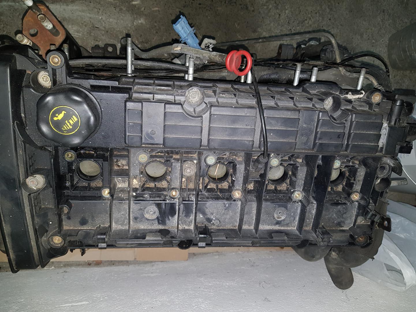

bojke 134 Posted January 31, 2018 (edited) Edited January 31, 2018 by bojke 4 neshaoct, jevta BG, Majstor_Paja and 1 other reacted to this Quote Share this post Link to post Share on other sites

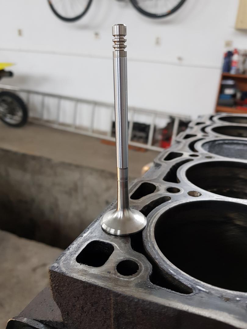

jevta BG 111 Posted January 31, 2018 Top...jel ovo motor za rezervu... Quote Share this post Link to post Share on other sites
bojke 134 Posted January 31, 2018 Taj ce se polako pripremati,bez zurbe. Inace je 2.4 u pitanju. Quote Share this post Link to post Share on other sites

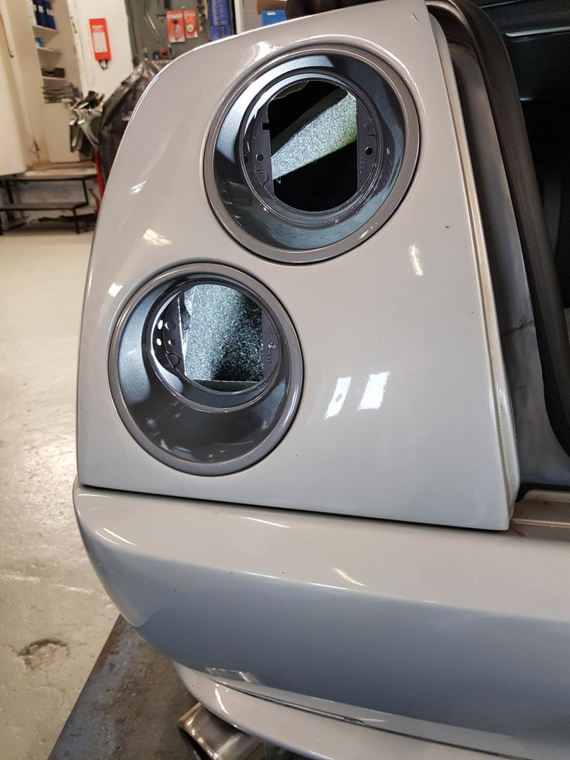

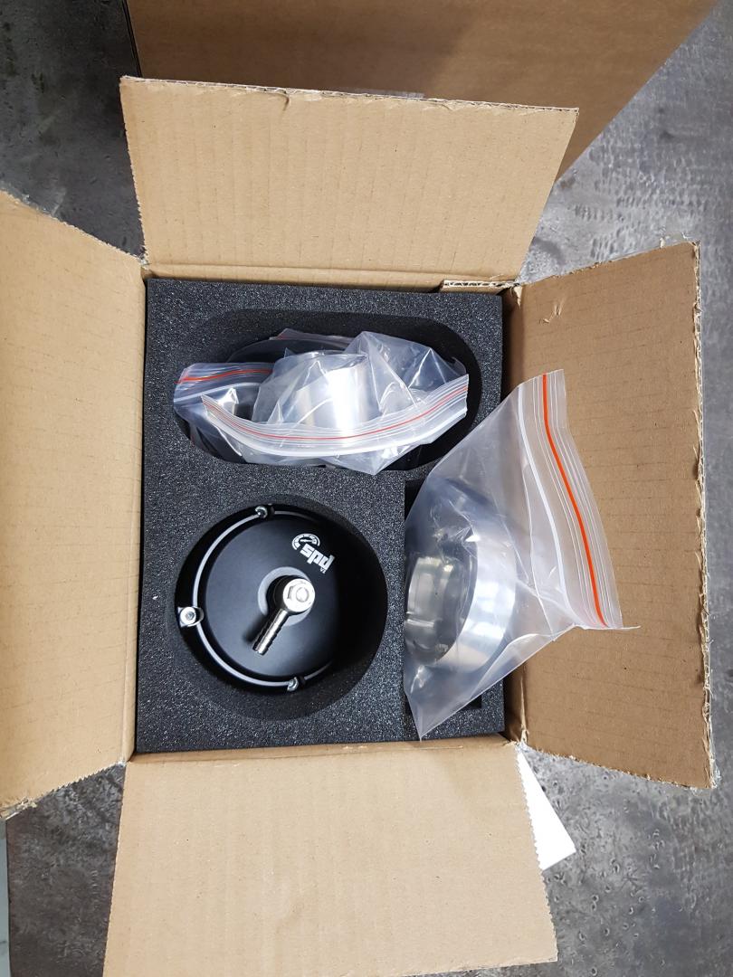

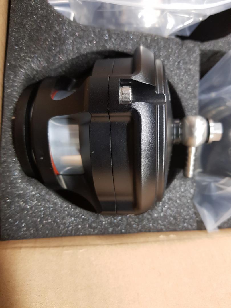

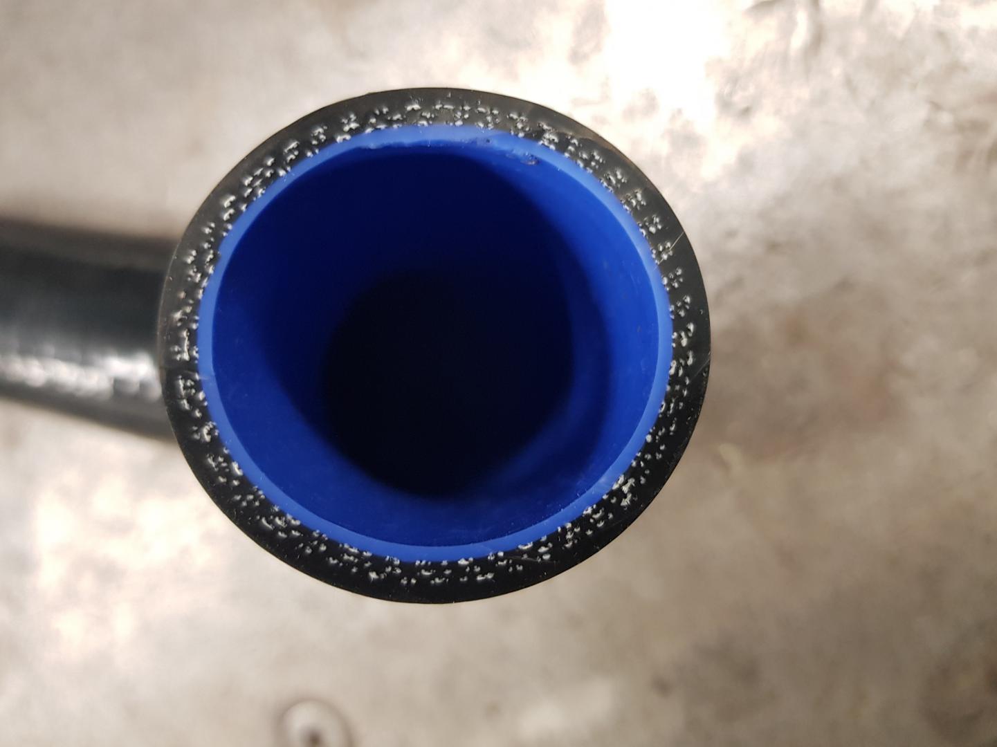

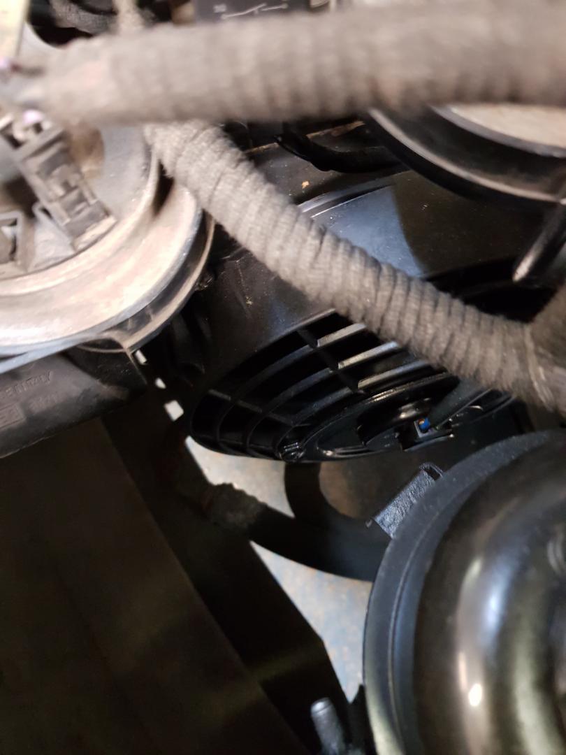

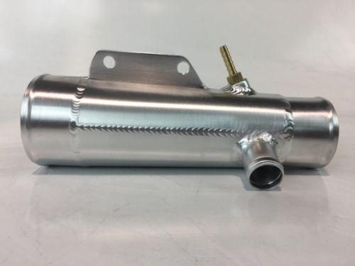

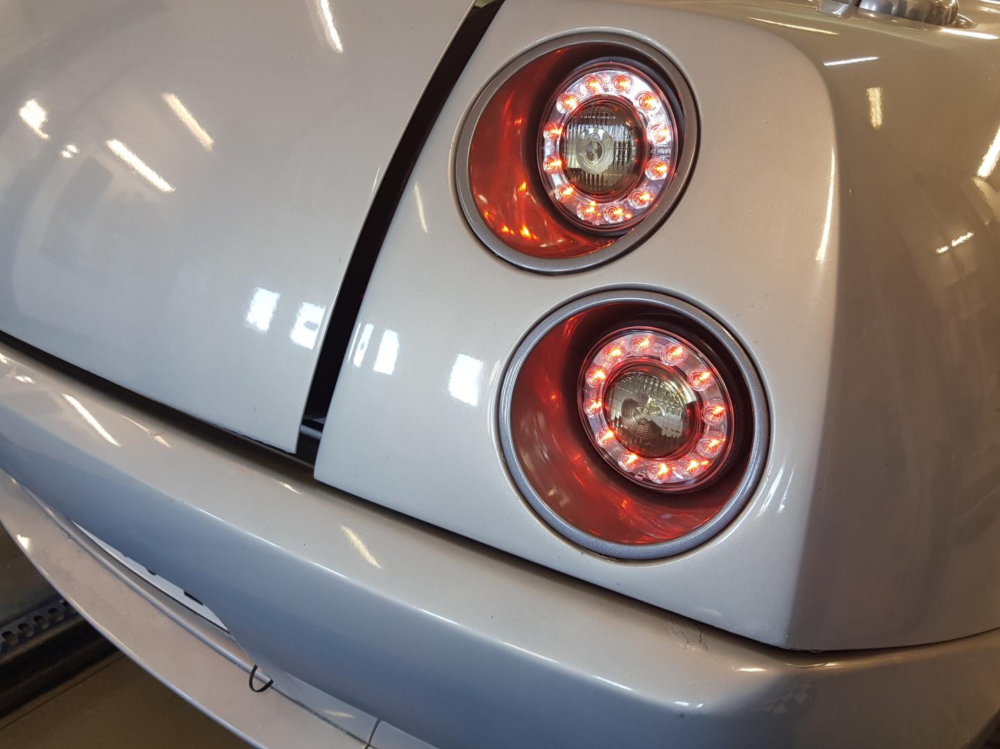

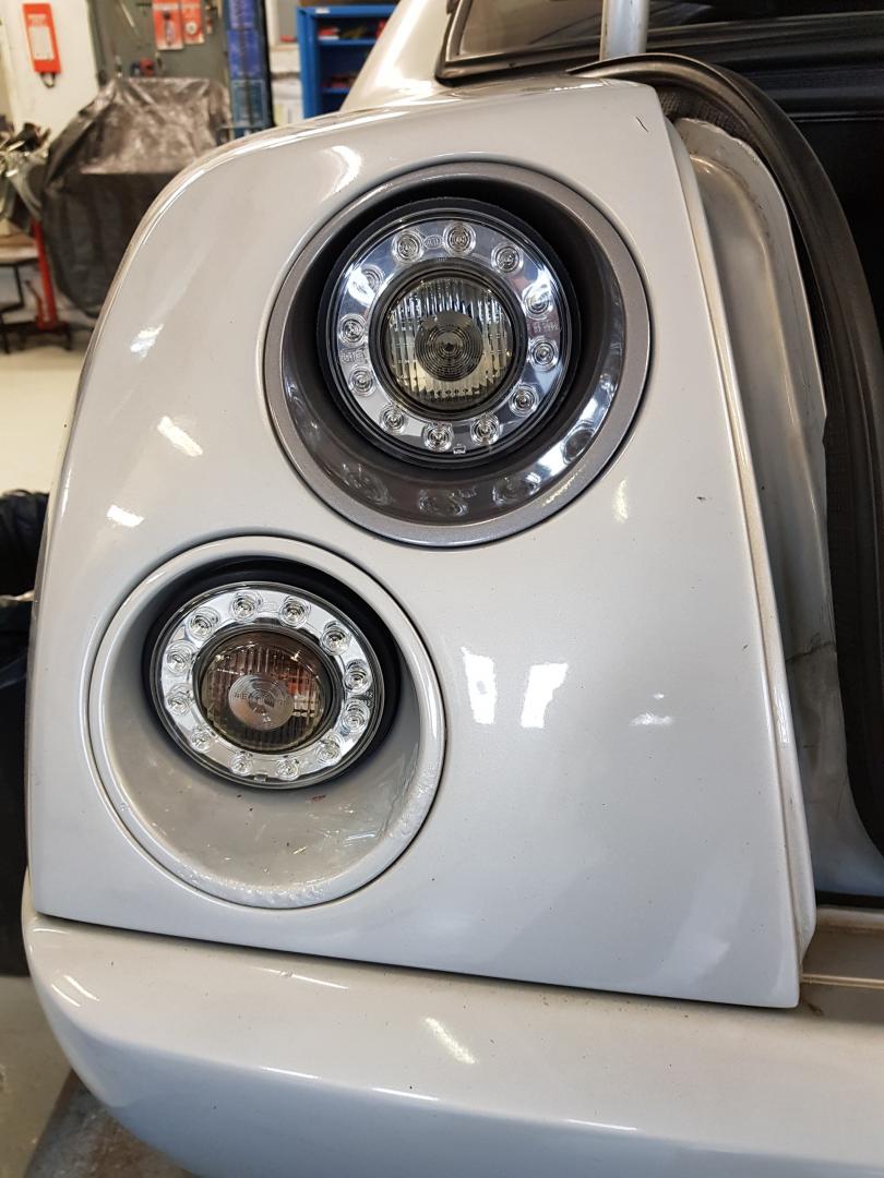

bojke 134 Posted March 16, 2018 Dugo sam se razmisljao i na kraju odlucio da ofarbam ovaj deo oko stop lampi. Hladnjak ulja je dobio svoj ventilator jer se pokazalo da mu je potreban. Na red je dosla i treca generacija dump ventila od 50mm. Bice potrebno fabricku plasticnu usisnu cev zameniti aluminijumskom i tu su svrhu kupljene cevi od kojih ce to biti napravljeno. Sva fabricka creva za rashladnu tecnost starosti 19 godina bice zamenjena novim silikonskim preventivno,ujedno je na programu i zamena kompleta zupcastog sa pumpom za vodu. Bice posla za vikend. Sezona se blizi. 2 neshaoct and PremieRacing reacted to this Quote Share this post Link to post Share on other sites
