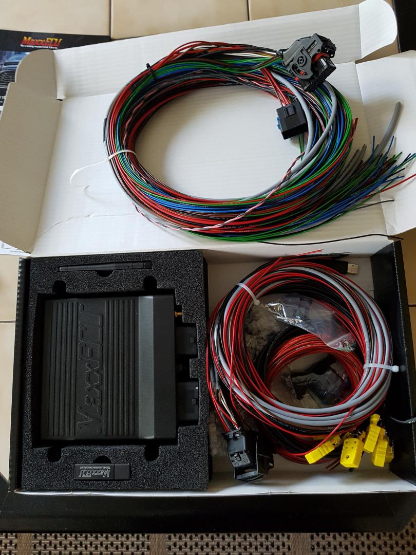

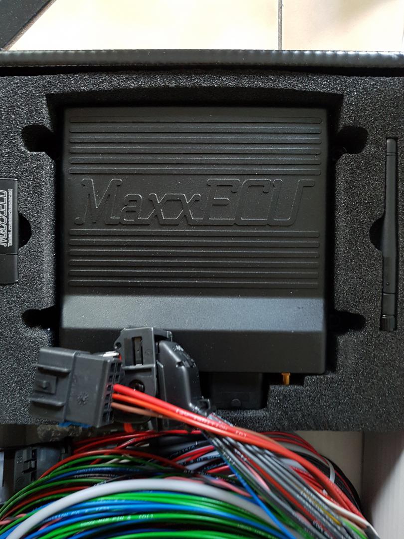

bojke 134 Posted July 18, 2017 Maxxecu Race standalone. Od bitnijih opcija tu su: Anti lag Launch control Traction control Shift cut Flexfuel Quote Share this post Link to post Share on other sites

bojankov 36 Posted July 18, 2017 Shift cut je saltanje bez kvacila ili? Quote Share this post Link to post Share on other sites
bojke 134 Posted July 19, 2017 Saltanje bez pustanja gasa pri kome racunar vrsi retardaciju paljenja ili ubrizgavanja goriva da bi se smanjilo vreme saltanja i motor zadrzao u boostu. Quote Share this post Link to post Share on other sites
bojankov 36 Posted July 19, 2017 A bravo jes. Sjetih se prije nego sam sad procitao post... svaka tebi cast. Quote Share this post Link to post Share on other sites

DraganUS 450 Posted July 19, 2017 Takozvani NLS. Standalone ecu je mama na starijim turbacima. Quote Share this post Link to post Share on other sites

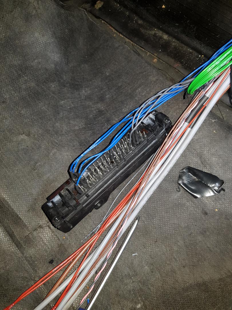

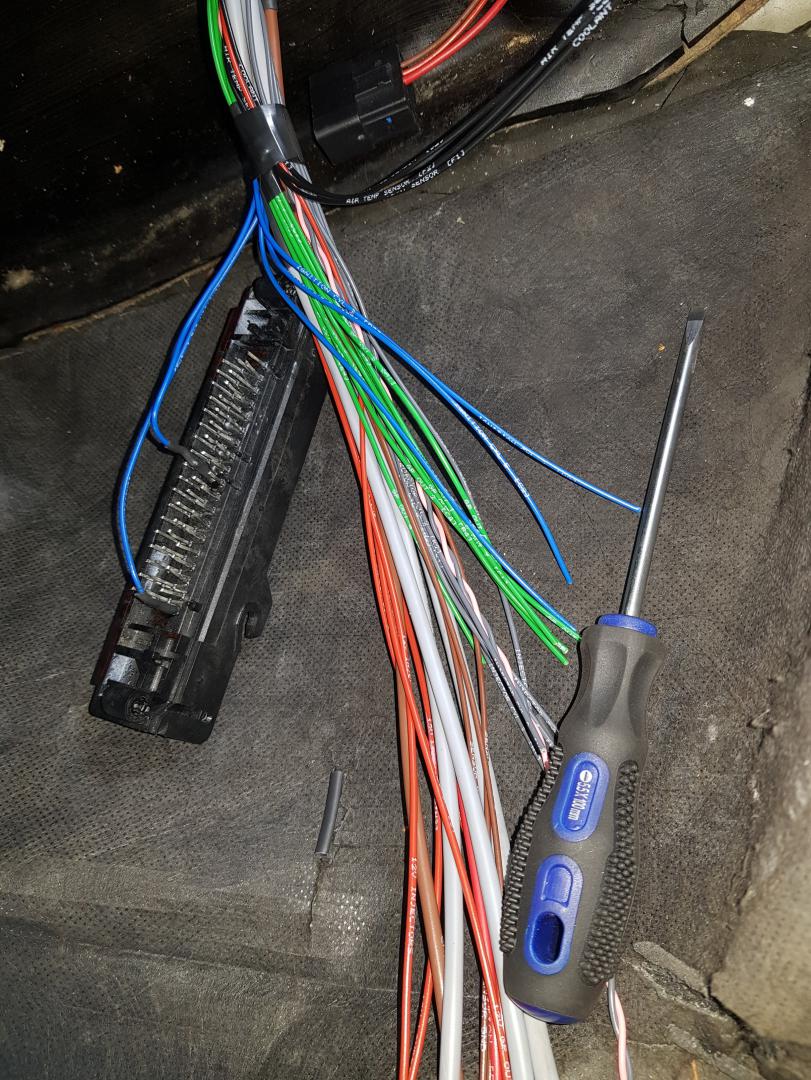

bojke 134 Posted August 9, 2017 Novi stage. Krenulo se sa "razvaljivanjem" starih instalacija za wideband i boost kontroler kao i sa povezivanjem standalona. veliki posao koji treba uraditi po PS-u.Zato ne zurim da bi na kraju sve radilo u fulu. U pomoc je pritekao i glavni majstor. Quote Share this post Link to post Share on other sites
