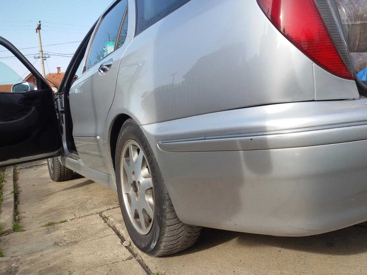

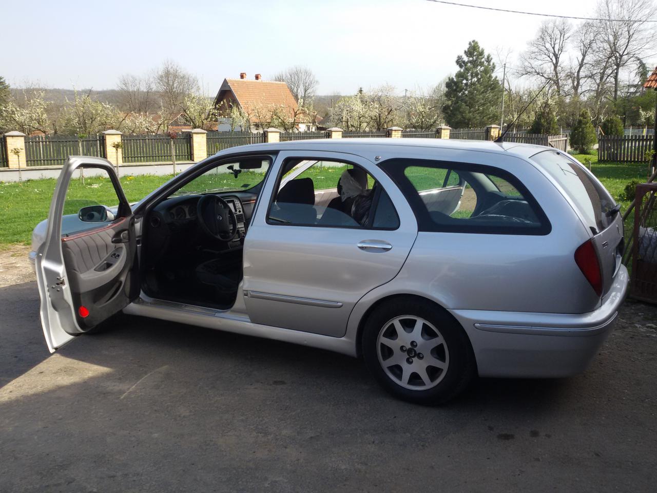

Marko Topola 71 Posted April 8, 2016 Evo slika moje sa 350-400kg tereta. Quote Share this post Link to post Share on other sites
