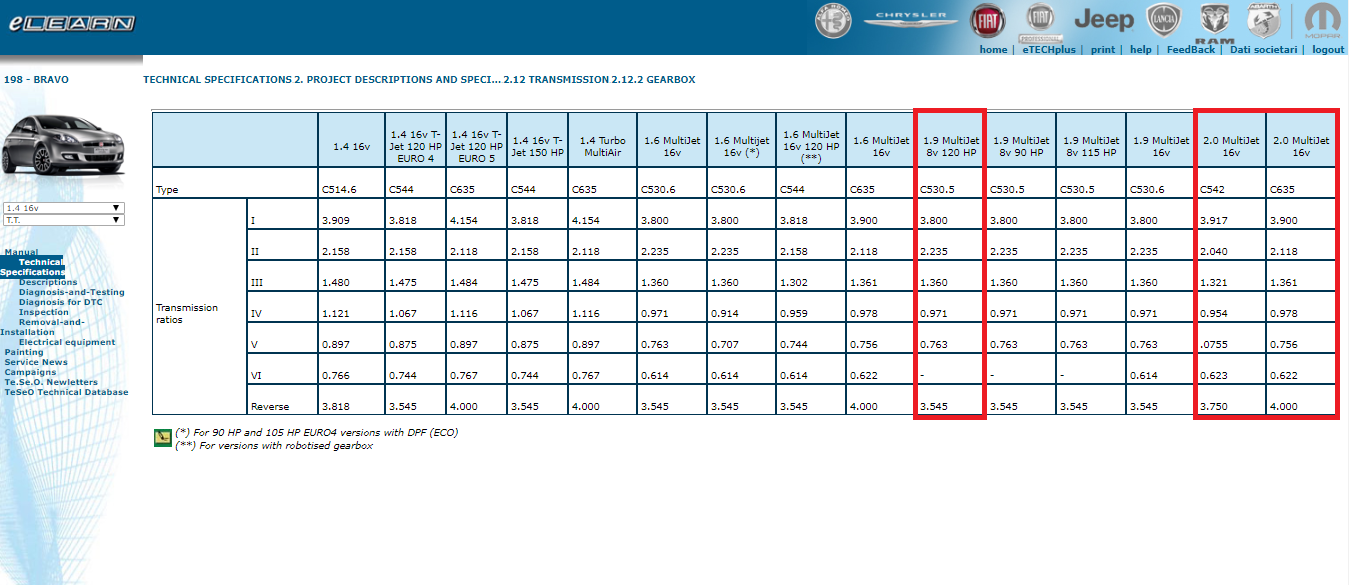

Ivan 22036 Posted May 23, 2023 (edited) Kakav covek, kakav gigant ... Sve turbo verzije Brava su posle 2010. i restyle dobile tada novi FPT-ov (zabarski) C635 menjac. I benzinci (T-Jet 120, MultiAir 140) i dizelasi (MultiJet 1.6 i 2.0). Evo ti pa sacni (ovo sam nekome nesto ranije uokvirio pa zanemari). U svakom slucaju, uvek mozes da proveris sta ti je na autu preko VIN i ePer: Edited May 23, 2023 by Ivan Quote Share this post Link to post Share on other sites

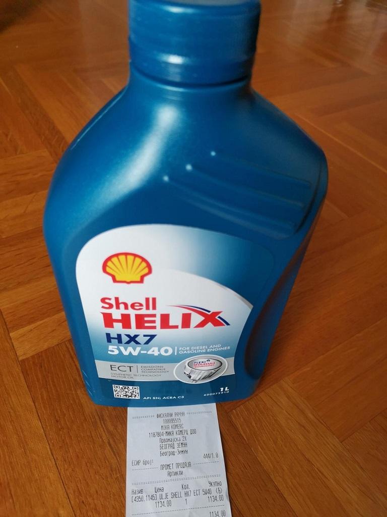

Ivan 22036 Posted June 24, 2023 (edited) Dobih info da se nesto tesko nalazi u prodaji, pa kupih za kolegu. Ako nekome zatreba info - Shell Helix HX7 ECT imaju kod AutoMike. Redovna cena je 1.260 din, a sa nasim klupskim popustom je 1.134 din: Pakovanje od 4l nemaju, ali mozda moze da se poruci, tako mi rekose. Edited June 24, 2023 by Ivan 1 neshtry reacted to this Quote Share this post Link to post Share on other sites

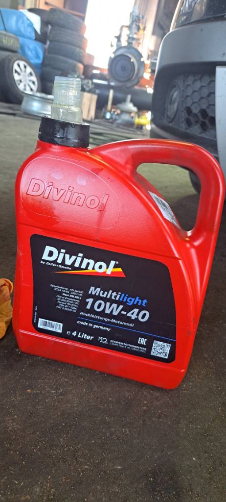

shuxx 15915 Posted June 27, 2023 Kakvo je misljenje o ovom ulju. Divinol...Sent from my SM-A536B using Tapatalk Quote Share this post Link to post Share on other sites
Ivan 22036 Posted June 27, 2023 Divino je . 2 shuxx and notalone reacted to this Quote Share this post Link to post Share on other sites
neshtry 19599 Posted June 27, 2023 Stara nemačka firma sa rafinerijom koja se bavi uljima u mazivima od kraja 19 veka,trebalo bi da je dobro Quote Share this post Link to post Share on other sites

MS PK 8275 Posted June 27, 2023 Kakvo je misljenje o ovom ulju. Divinol...Sent from my SM-A536B using TapatalkMislim se, gde ga iskopa Послато са SM-A307FN помоћу Тапатока 1 2 darkman14, Axic and Ivan reacted to this Quote Share this post Link to post Share on other sites
shuxx 15915 Posted June 27, 2023 Koriste ga moji za sluzbena vozila. Zamena na 10 k km. Ja utepah 40k km za godinu dana.Ide Golf ko blesav Sent from my SM-A536B using Tapatalk 1 MS PK reacted to this Quote Share this post Link to post Share on other sites
