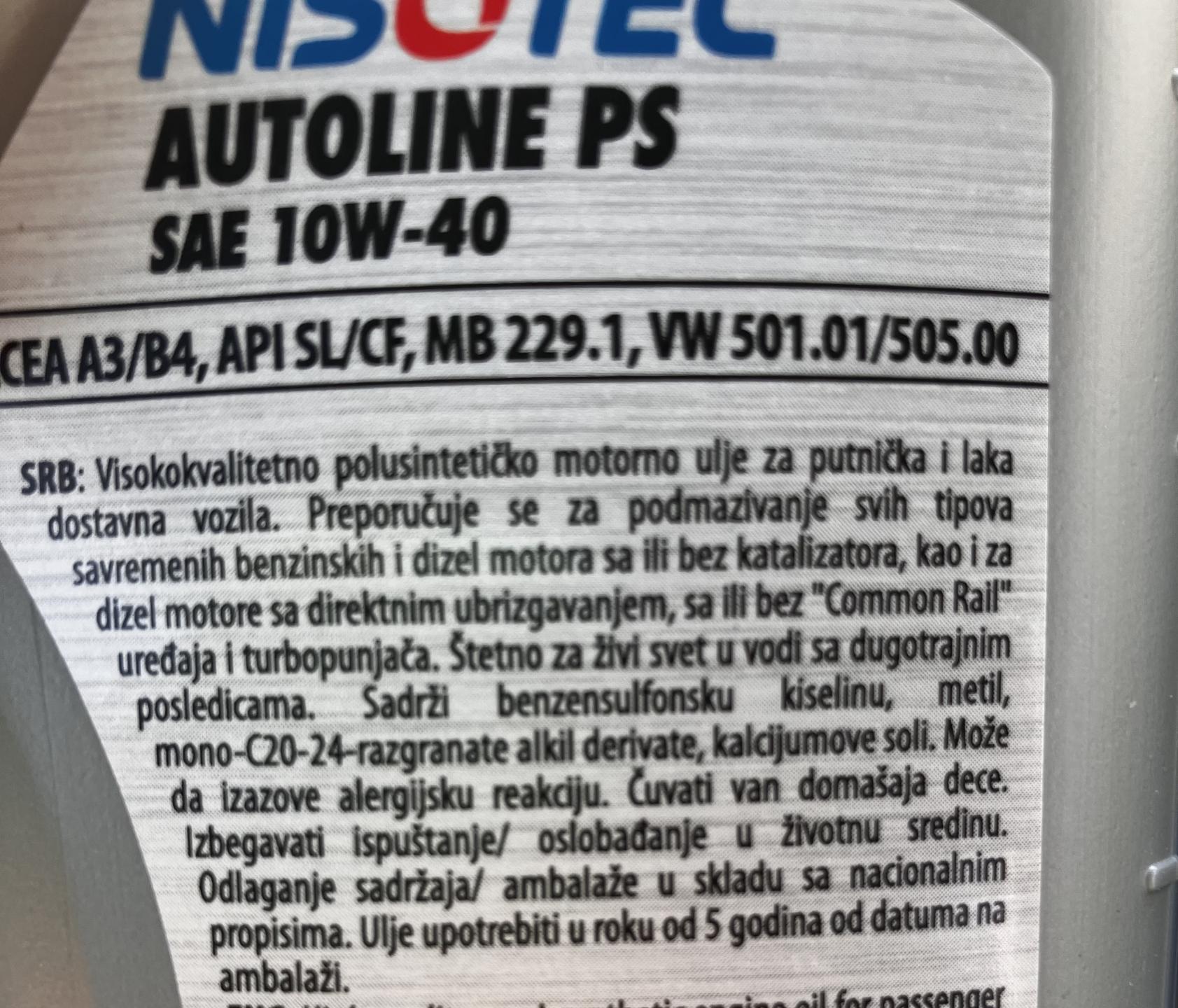

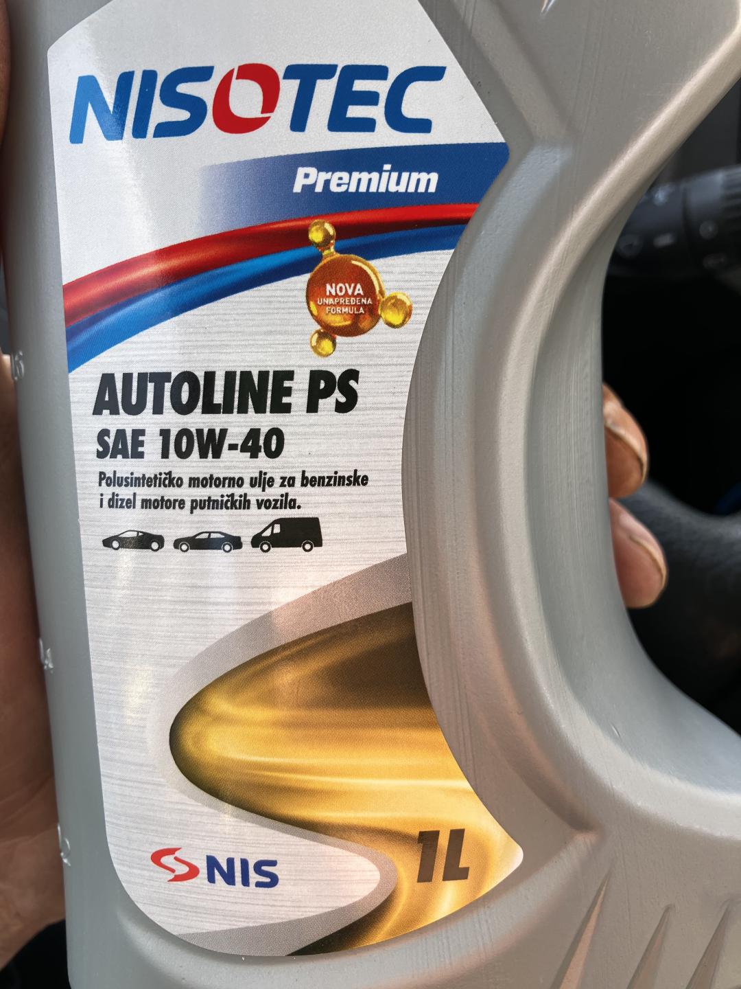

neshtry 14790 Posted February 8, 2023 (edited) 500 dindži,uzeo za dosipavanje pre zamene na malom servisu i za kosilicu posle… Nova,unapređena formula i nova ambalaža Svojstva ulja Nisotec 10w40 samisintetic Edited February 8, 2023 by Ivan Sredjene slike 1 stex_pb reacted to this Quote Share this post Link to post Share on other sites

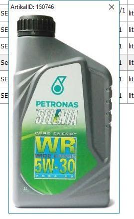

integralac 2566 Posted March 6, 2023 Jel moze ovo ulje kod mene u Miltiair masinu? To su mi poslali po preporuci, naglasio sam za Multiair ali pitanje je koliko prodavci znaju Quote Share this post Link to post Share on other sites

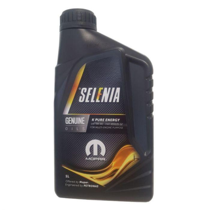

OMP 2178 Posted March 6, 2023 (edited) Koliko ja znam za MA ide 5-40 ulje i imas bas seleniu multi air pjur enerdzi oznaka crvena kanta, sto bi eksperimentisao sa ovim 5w30 njega furaju u dizelima Edited March 6, 2023 by OMP Quote Share this post Link to post Share on other sites
integralac 2566 Posted March 6, 2023 Sad smo citali na kantici, pise da je za dizela, posle smo zvali Gazelu i kao u jeee jeste, nasa greska, uzasni su, sutra cu da kupim negde neko drugo ulje, moram veceras da iscitam celu ovu temu Quote Share this post Link to post Share on other sites

Nikola031 940 Posted March 6, 2023 3 hours ago, integralac said: Jel moze ovo ulje kod mene u Miltiair masinu? Koliko znam u MultiAir ide 5w40, fabricki preporucena je Selenia KPE MultiAir. Kod mene u Punta sipam Shell Helix HX8 ECT 5w40 i za sada je ok. 1 frostysrb reacted to this Quote Share this post Link to post Share on other sites

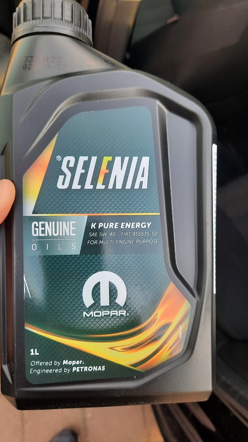

Ivan 17593 Posted March 6, 2023 26 minutes ago, Nikola031 said: Koliko znam u MultiAir ide 5w40, fabricki preporucena je Selenia KPE MultiAir. Tako je. I bitno je napomenuti i Fiatov S2 sertifikat (955535 S2), takodje da je ACEA C3. Ako se kupuje ulje nekog drugog proizvodjaca. 2 hours ago, OMP said: Imas sad i ono novo Selenia pakovanje: 1 nemanja84bg reacted to this Quote Share this post Link to post Share on other sites
integralac 2566 Posted March 6, 2023 Zahvaljujem, videcu sutra sta ima u nasem malenom gradu. Quote Share this post Link to post Share on other sites
OMP 2178 Posted March 6, 2023 uzmi ovo mopar ti se lozis na dodzeve 1 nemanja84bg reacted to this Quote Share this post Link to post Share on other sites
integralac 2566 Posted March 6, 2023 Normalno, kupujem Challenger SRT uskoro Gde ima taj Mopar, cije je to mazivo? 1 nemanja84bg reacted to this Quote Share this post Link to post Share on other sites
OMP 2178 Posted March 7, 2023 (edited) To je isto petronas seljania kao i sto original ricambi delovi nose mopar oznaku, amerikanizovano je sve to propala stvar nacisto Edited March 7, 2023 by OMP Quote Share this post Link to post Share on other sites
integralac 2566 Posted March 9, 2023 Na kraju to i uzeo 4 horvat, stex_pb, neshtry and 1 other reacted to this Quote Share this post Link to post Share on other sites
Ivan 17593 Posted March 9, 2023 Revansiraj se bar informacijom o trenutnoj ceni . 1 nemanja84bg reacted to this Quote Share this post Link to post Share on other sites
integralac 2566 Posted March 9, 2023 1370 din u Gazeli Krusevac, ne znam dal ima na to majstorski popust ili mi je uzeo punu cenu ali toliko sam dao 1 Ivan reacted to this Quote Share this post Link to post Share on other sites

NIXIE 77 Posted March 13, 2023 (edited) Tek sam se učlanio na forum, tako da za početak imam samo jedno lagano pitanje. Već skoro 11 godina vozim Grande punto 1,3multijet 75KS Euro 4 kupljen polovan u Delti (Carmarket) 2012god. Auto je 2009 godište, kupljen sa 44000km, danas ima 154000km. Po knjižici njemu sleduje Selenia 5W40 WR. To ulje je sipano dva puta u Delti na redovnom servisu, a na trećem servisu sipano je Selenia 5W30 WR (C2) i ako auto nema DPF. Nakon toga ja sam kupio auto pa nastavio da sipam to ulje do dana današnjeg, i nisam imao nikakvih problema. Potrošnja ulja je ista kao i prvog dana znači 5mm možda i manje spusti na šipki za 10-11000km koliko godišnje pređem, od toga 80% je drljanje po Beogradu prosečnom brzinom oko 20km/h. Za vreme Korone nisam ga skoro ni vozio. Auto održavam kod Gorana na Altini. Pre nedelju dana sam kupio 500L 1,3multijet 95KS Euro 6 u AK Kompresor, 2017 godište, kilometraža 48000km. Vozim ga tek par dana. Po knjižici njemu sleduje Selenia 0W30 WR Forward (C2). Redovan servis su uradili u AK kompresor neposredno pre prodaje, i tom prilikom sipano je ulje Shell Helix Ultra 5W30 ( ECT C3). Pitanje je da li je to ulje odgovarajuće za taj motor, ili da ga teram kod Gorana i menjam odmah sa ovim iz knjižice? Unapred zahvaljujem. Edited March 13, 2023 by NIXIE Quote Share this post Link to post Share on other sites
