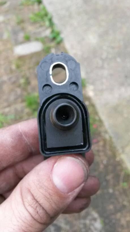

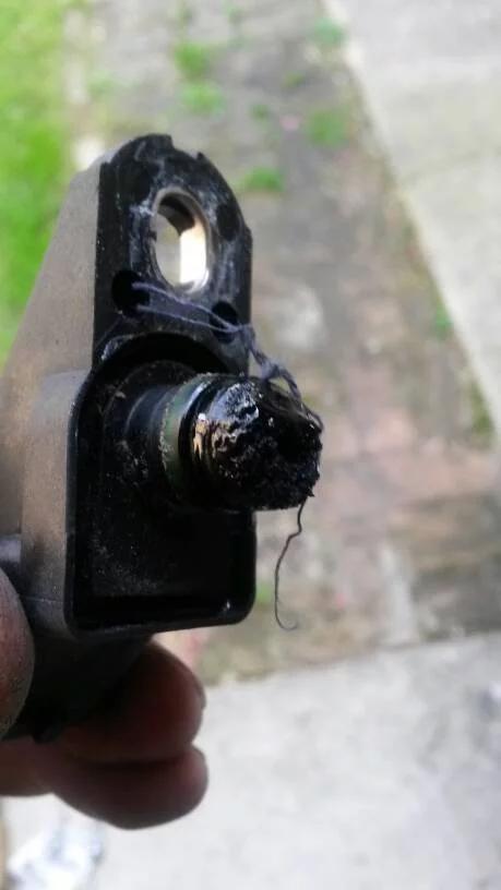

yunoise 0 Posted October 7, 2014 Ovako je MAP izgledao pre ciscenja A posle ciscenja izgleda ovako Od sprejeva pri ruci mi je bio kontakt sprej, i sa njim mali stapica za usi sam uspeo da ocistim kako treba. Quote Share this post Link to post Share on other sites

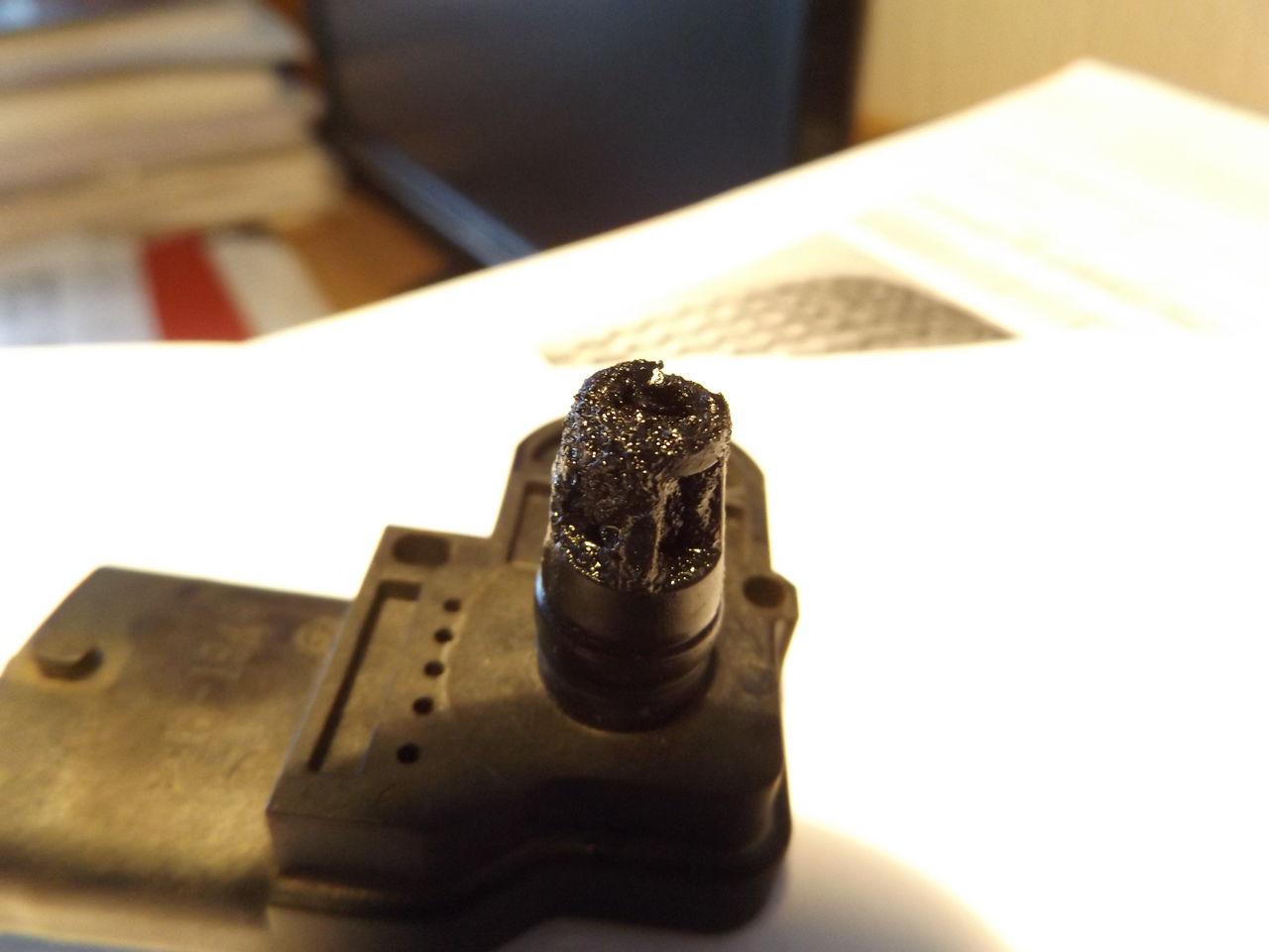

banjo1990 265 Posted February 28, 2015 Evo i ja da doprinesem jednom sličicom Alfinog MAP senzora. Quote Share this post Link to post Share on other sites
vicent 1295 Posted February 28, 2015 Sve je to do ekologije i EGR-a. Šta misliš,kakav je usis i dekl glave. Quote Share this post Link to post Share on other sites
banjo1990 265 Posted March 2, 2015 Mogu samo da zamislim... Baš bih voleo da skinem usisnu granu, da vidim i to... Quote Share this post Link to post Share on other sites
Bocca 2 Posted March 2, 2015 Sve se to cisti lepo Quote Share this post Link to post Share on other sites
vicent 1295 Posted March 2, 2015 Ma ne želim više da čistim! Blombirao sam EGR i sve je čisto nakon 15hkn. Quote Share this post Link to post Share on other sites
