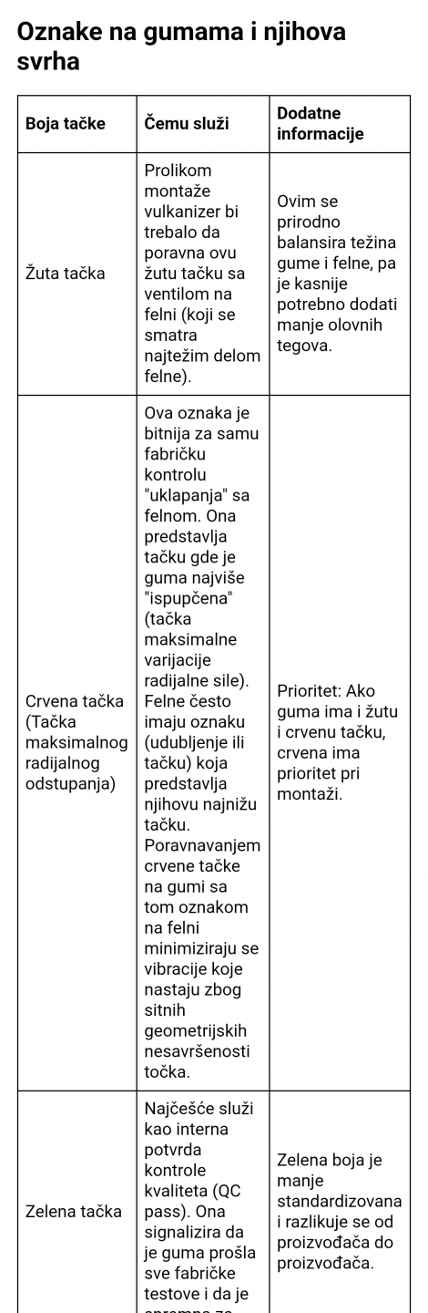

knezevic76 10033 Posted March 31 (edited) Edited April 1 by Ivan Sredjena "webp" slika, skinut TT potpis 2 2 Kosta Smosta, kakoonobese, shuxx and 1 other reacted to this Quote Share this post Link to post Share on other sites
